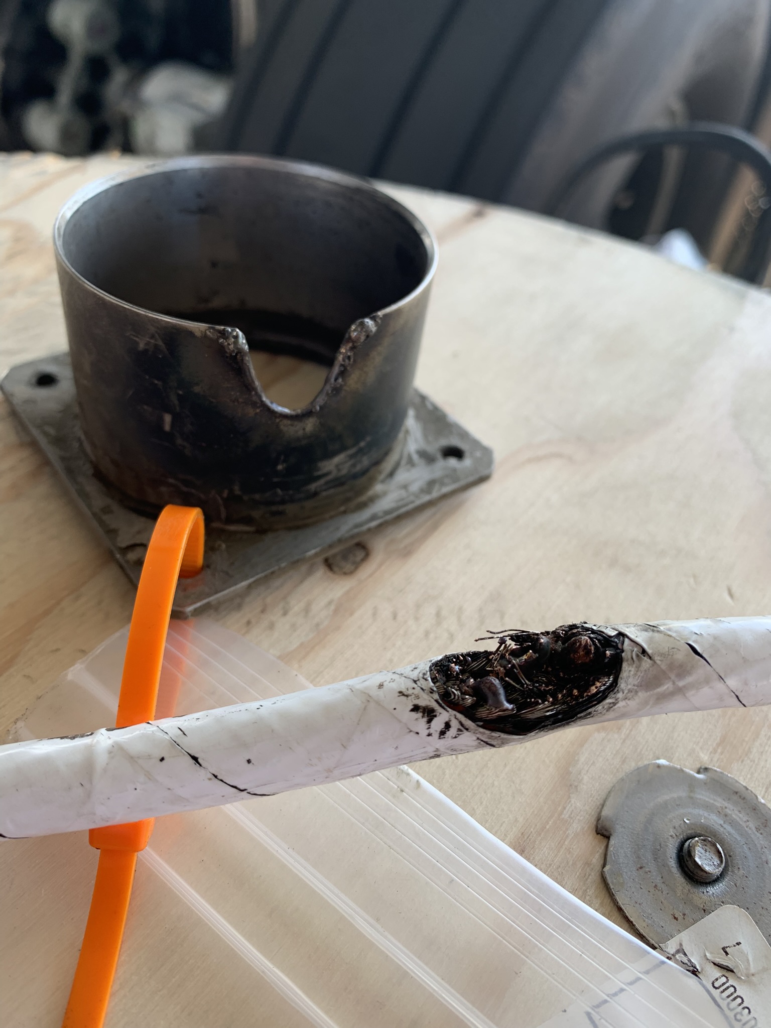

The crap I'm finding on a weekly basis is disheartening to say the least!
Duct broken, sensors laying on ceiling light.
Heat from light caused a "Duct Overtemp" warning from tripping the high temp bulb.
