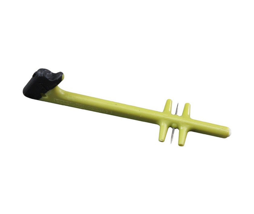

Is it permissible to paint static wicks? If so, what characteristics must the paint possess?”

Replied by Mark on topic Static wicks
I would say no.
Static wicks discharge electrical potential differences between the atmosphere and the aircraft.
They are designed to dissipate electrical charge in a slow controlled rate instead of a quick "pop" (like dragging your feet on carpet in a dry environment and then touching a door handle).
A slow discharge keeps static interference on voice communications to a minimum.
I have never seen wicks painted on commercial, corporate, or piston-popper aircraft.
Paint would interfere with the wicks ability to perform its job.
