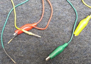

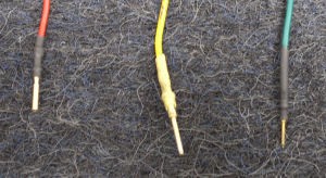

I use test leads that I made from Radio Shack® alligator clip jumper wires. I cut them in half and crimped various size pins on them. I use heat shrink tubing to protect all but the working end of the pin.
I ground down the tips of my meter test leads about ¼" to accommodate the alligator clips. When I hook up to the meter lead, I push the rubber of the clip over the plastic of the lead. This prevents inadvertent grounding of the alligator clip on metal. It's always nice to see that split second of flash and spark, then be left wondering what you just fried.
I like to have at least two each male and female sizes in the red (20) and blue (16) gauge pins. Digital computers use smaller pins in the 24-26 gauge range. The males in this range are easier to obtain because the rack plugs use them. The females are not easy to find, they are on the computer (LRU) plugs. The component shops have them, but line mechanics do not normally have access to these. The problem is, the females are needed to get into the rack pins for troubleshooting. If you find any females in this smaller size, take care of them.
